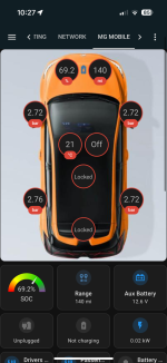

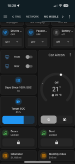

I spent a while messing with this. It has some custom helpers such as converting km to miles etc.
You'll need to download mushroom cards but then can paste in the templates.
You'll need to also put in your vin where noted. (use notepad to replace)
I'll upload when I can
Ok, I have sanitised so first thing you'll need to do is find your vin and paste the below configurations into Notepad++ and Find and Replace "REPLACEME" with your VIN.
This is typically the LS** number on your homeassistant.local:8123/config/devices/dashboard?historyBack=1&domain=mqtt next to MG MG4 Electric LS*********
Template Sensor Setup ( homeassistant.local:8123/config/helpers ) Create > Template > Template A Sensor. Do these one by one as noted by the dashes.
