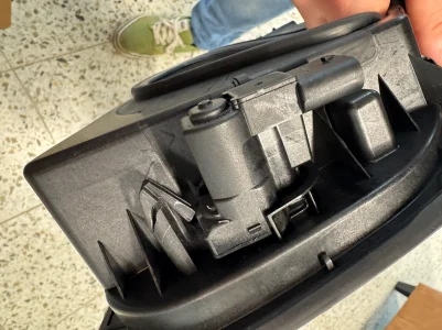

Update on this, got to my dealer and they are again champs. They had the charge port disassembled in like 10 minutes and the source of the issue determined - a pretty obvious material defect visible on the photo that allowed the push pin assembly to rock freely inside.
Apparently MG doesn't offer the broken clip/push pin individually and the whole charge port assembly (outer rim, drip tray/tubes and flap arm) needs to be switched out, and can't be repaired and then refitted as removing it in the first place requires breaking off mounting pins/brackets, seemingly intentionally.
I was a bit fearful at first, as my dealer told me prior to starting that the spare would have been around 150€ if MG decided to void the warranty claim, probably by claiming mechanical damage (there was none). If it had come to that I would've argued strongly that a charge port that lasts mere 3500km and only a dozen charge sessions is a clear product defect. I also made it clear to my dealer that there are other MG owners out there with similar issues.
Luckily they had a spare charge port assembly at hand that they were able to switch to my car, detatch my original charge port flap from the defective part and onto the new assembly, and I'm good again. And didn't cost me a penny (or an Euro cent).
The only worrying thing is that how long will the spares last... Can't treat this kind of a quality issue with silicone alone.
