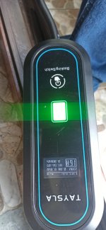

Apologies for not being clear, this was a 'granny charger' that plugs directly into the mains- I tried 2 different ones, the only one that worked when away from home was one of these.

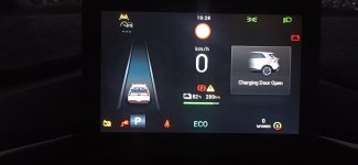

Hi guys, I am having troubles charging my SR MG4. I've seen this yellow battery icon (see picture attached) on the screen, is it possible to be the main reason why it won't start charging and what could be an easy fix solution? Thanks

@dannyg3081 can you post here a couple pictures of the granny charger? To show us two things:
1) any lights to indicate a fault?
2) the granny charger’s specification.
There is no fault on the charger. Is a Taysla charger because the car didn't come with it's own granny charger, only with Type 2. What I could see is that is not recognizing the ground, the charger I had with my previous car, had no issue with that. The ground is very well done, because I have two solar panels systems.

I think I've got it, the main battery is in shut off mode. I have no idea how to solve this issue. I wanted to disconnect the 12 V battery but since you need to start with minus, I've given up because I couldn't disconnect it.

From what you showed though, there is nothing anormal. If your car is plugged but not charging then the battery should be cut-off so the indicator should be lit according to that fact.

My problem was the granny charger(s) were not 10A, but 12A - hence why I said that the MG4 was fussy. Never had another issue once I got a genuine MG charger.
