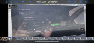

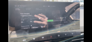

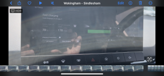

Went to Tesla Wokingham yesterday (138kW max) and I achieved:
134kW from 29%-55% SOC (basically the maximum the supercharger can do with losses).
103kW at 60%
67kW at 70%
57kW at 80%
28kW at 90%
It took 30 mins to go from 29-90%.
This was after a drive of 2.5-3 hours so battery was nice and warm.

This is really good - better than most EVs in this class will achieve in the real world.
Anything above 80-90% SOC is really slow and should only be done if absolutely necessary. Did it once (in the Ioniq 5 though) before going back from Italy, and 90-100% took almost as long as 20-80%.
Yes, past 90% it gets slower and slower and never worth getting to 100% unless you absolutely need it.

At what point did it drop from 57kw to 28kw?
These are the more detailed readings I took:
79% 58.5kW
80% 57.0kW
82% 55.1kW
84% 52.9kW
85% 49.6kW
86% 38.1kW
88% 32.6kW
89% 30.5kW
90% 28.4kW
So there's was a slow drop off and then after 85% the rate plunged rapidly then dropped off more slowly again.
79% 58.5kW
80% 57.0kW
82% 55.1kW
84% 52.9kW
85% 49.6kW
86% 38.1kW
88% 32.6kW
89% 30.5kW
90% 28.4kW
That's great performance. Worth staying to 85%, which is more than enough to be on your way.
