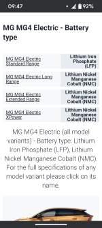

Somewhat confused ? - After 4 months of ownership I'm still surprised how easy it is to confuse me ( line up 3 shovels, tell me to take my pick ?!?!?! ).
I was convinced from what I'd read and seen, my SE LR had an LFP battery. I was happy with this as this was what I'd had in my Kia Soul with no degradation over 5 years and 48k.
Then, reading earlier posts in this thread and doing another 'google' I came across the attached. And no, the SE LR is NMC apparently ?. But this is ok as it's a more tolerant chemistry.
And as for type 1, 2 or 3 - I can find references to it but no spec ( more ?) ..
* Apologies for thread (kinda) hijack.*
SE is the trim level, across two battery chemistries.
I'm more surprised by your Kia Soul comment because I'm pretty sure Kia only started using LFP batteries very recently and not on the Soul. I thought the Soul used an uncommon Lithium-ion polymer type of battery.
