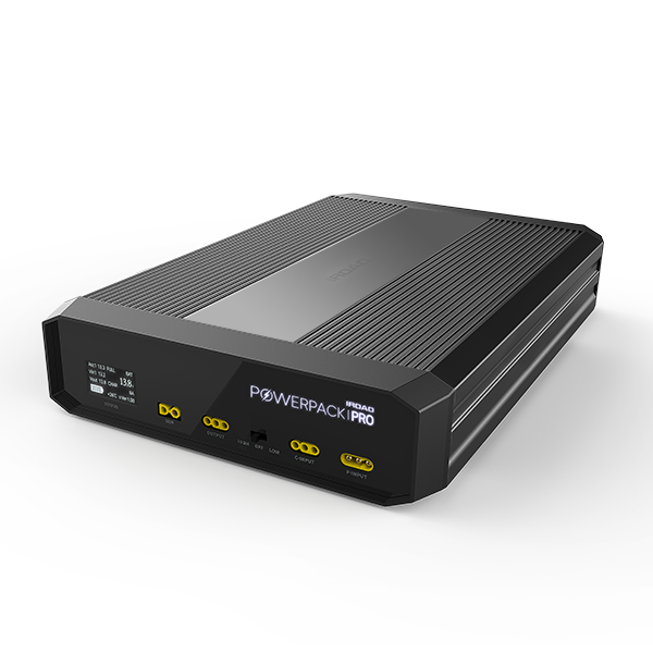

I just got an iRoad Pro12 installed today. I have a 2ch BlackVue setup (through the dealership) but found that the parking mode stopped working within several hours (I work at a school so parents dropping off kids triggers the camera a lot). It wasn’t cheap but with this battery it should be able to sustain parking mode for 48 hours, and never drain the 12V battery.
I will say that using BlackVue battery with BlackVue camera gives you some control over the battery through the app, whereas the iRoad doesn’t. But the iRoad does have more capacity and is LFP chemistry.

I just got an iRoad Pro12 installed today. I have a 2ch BlackVue setup (through the dealership) but found that the parking mode stopped working within several hours (I work at a school so parents dropping off kids triggers the camera a lot). It wasn’t cheap but with this battery it should be able to sustain parking mode for 48 hours, and never drain the 12v battery.

Strange, I thought main battery (HV battery) should periodically charge 12V battery, if it's drain, even in park mode. How it's possible that dashcam drains 12V battery up to cut off?
In theory, you are correct. The HV battery should top up the 12V battery. But in reality I don't have to worry about it, because the dashcam technically just runs off its own battery now, which charges when the car is on. So if for whatever reason the HV battery decides not to top up the 12V, I won't be stranded.
To be clear, I've never tried to see if the HV battery will charge before the 12V drains too far.
If possible, could you please share the photos how your iRoad Pro12 is installed.
