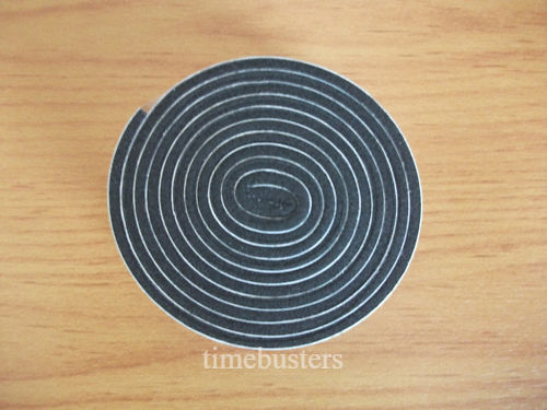

Do you have details of the tape that you used please?
Hi, can't seem to link to the ebay listing, but if you search for 10mm wide closed cell tape, 3mm thick, 2m long, you should find it. Cost is £4. When installed the 3mm foam compresses to about 1mm under the original seal, so its not noticeable, but it stops the original seal chafing on the glass, causing the annoying noise.
Hopefully, SAIC/MG will change the original seal surface at some point and resolve the issue going forward!
