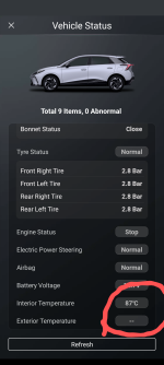

Same as you. Not that fussed. However, when setting the aircon, our Trophy seems to be 2-3 degrees colder than it displays hence we run it at 23 or 24 degrees compared with our previous cars at 20-21I have no idea. Do you think your Trophy is reporting the correct temperature? What does the app think the outside temperature is?
I am actually not that fussed about this. The external temperature measurement seems to be accurate enough, and I can probably take a good guess about the internal temperature from that. But if only SEs are doing the weird thing and Trophys aren't, it does suggest some sort of car-specific bug rather than a bug in the app.
I Agree. The only thing that is relevant is that you can set a max temp for inside (say 40c) and if it’s reached it auto turns on hvac to cool the interior.Sure, but you wouldn't ever want to set the temperature that high!
I would agree I would have expected it to start at 16 not 18.Everybody's system seems to show a temperature range from 18 to 32 though, irrespective of whether or not they think they're experiencing an offset and irrespective of what they think that offset is. (I think mine is 5 degrees.)
To me this is a very strange range for a car cabin heating system. 32 is way higher than anyone would ever want, while I'm sure most cars let you set the temperature lower than 18. My previous car went from 15 to 26 as far as I remember. If the temperature showing was actually accurate this could be a problem.
I'm not entirely sure what's going on here.
40c I'd be driving round in my pants ?I Agree. The only thing that is relevant is that you can set a max temp for inside (say 40c) and if it’s reached it auto turns on hvac to cool the interior.
Steady, I'm eating my breakfast40c I'd be driving round in my pants ?
At least my dealership was aware (and annoyed) of nearly every customer complaining about this.The temperature sensor in my opinion is simply not accurate. It basically reads and displays the temperature at 4 to 5 degrees higher than it actually is. This may be able to be adjusted in the software but is unlikely to be done unless every single owner complains to MG about it. But most people will just set it higher .
