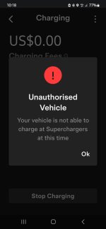

I had my MG ZS EV tweaked at my service in September to enable Tesla charges. I finally got around to testing the system at the public Supercharger at the Trafford entre and it doesn't work. Followed all instructions carefully. Uploaded and used their app - incredibly slowly
Why is mobile signal so often poor at charging stations?!
Any tips on where I might have gone wrong? I'll be ringing the MG Dealer tomorrow. I'm glad I checked when I wasn't on a long, time critical journey.

If you still getting "unauthorised vehicle" they haven't properly patched it. I would take it back and ask them to try again.
My car works every time at the Trafford Centre location.
