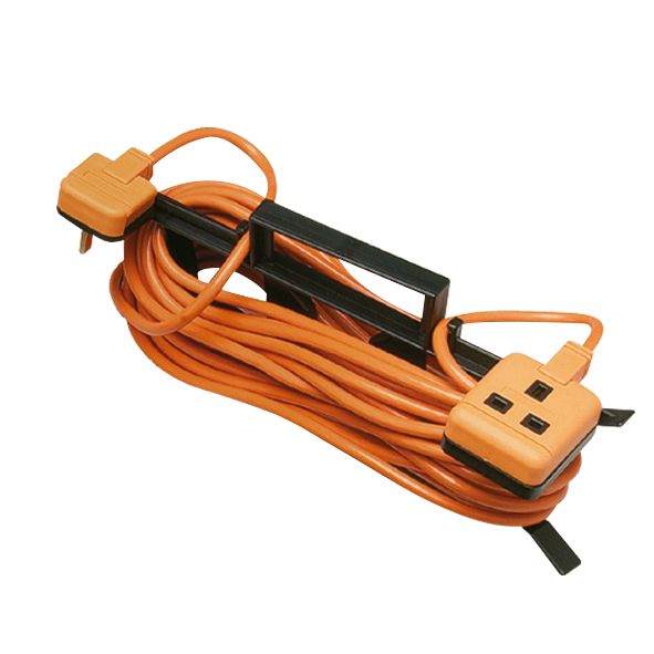

We are going on a road trip, (Whitby from kent). A couple of places we are staying in, I'm planning to granny charge and a extension lead might be needed. I'm no expert and I don't want it to melt!
I occasionally use a 45M extension cable to charge with no issues whatsoever, just remember not to leave any spare cable coiled.

The one from Wickes is weather proof, hence the higher price
Just make sure you fully unwind it as you are pushing it to its maximum.
Not so long ago I was using a power tool, was on for about an hour solid, had only unwound the extension cable by a few metres...... it tripped the protection on the extension lead and when I touched the cable it was so hot I couldn't hold it, the cable was so flexible when it was hot it was amazing lol.

I would make sure the specs for the cable are listed and it's a 13A continuous rated extension (when fully unwound), not a 13A max one.
The Granny draws 10A IIRC.
