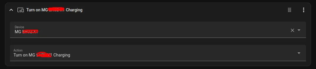

So how do you turn charging on and off with the custom integration?
ah ok ... didn't realize there were 2 options ...
I use this action to turn on charging and there's another action to turn it off
