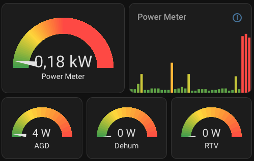

@wattmatters I just added your gauge to one of my dashboards:
Showed it to my other half, and then showed her the code.
She said "Bl**dy h*ll! He must have even more time on his hands than you."
