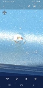

Whilst washing my 16month old ZS EV on Friday I noticed a mark on the front middle of the roof. On closer investigation I saw it was a rust spot. Looks like from under the paint. Took it down to the dealer and I am waiting on response from MG

That doesn’t look good - it looks like corrosion from within the panel. Thanks for sharing.
