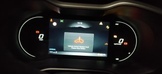

Today I had the HV Battery shut off come up on my car see photograph , I couldn’t get the car to go into drive or reverse mode , just kept on going in to N neutral tried 3 or 4 times and then done a google search and someone had said keep foot on break a bit longer and it seemed to work, don’t know if that was just a coincidence or do I need to take it to MG garage, I’ve only had car 2 weeks and done less than 100 miles
Just having read all other posts, I’ve only ever charged on my home charger once when I first picked up the car as dealer failed to put a proper charge in vehicle, never had any issue with this error until today.

Quite common if you rush startup I just keep foot on brake till it says ready
Thank you , that’s what I found when done a Google search , it’s reassuring to read your comment ???

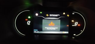

We didn't have the HV battery warning message we had a different one, see photo below.
Problem started mid November the day after using a public 22kw charger. We always charge at home from our 7kw Zappi but were on a rare long journey and needed to charge to get home.
Next day the wife was driving when the car cut out mid flight with a message on the dashboard. Luckily no traffic about and she switched off and on again and all was fine and she continued with her journey.
Same thing happened 2 days later, and again the day after that.
Two more good days passed before it happened a 4th time when I was driving. The car was unable to select F or R for half an hour as I tried many times to switch off and on again and get out of the car and lock and unlock before it suddenly cleared and I was able to turn around and drive the 200 yards back home. I organised MG ASSIST recovery at that point and the car has been with the dealers ever since.
I'm an electrical engineer so have let them know and asked for full technical info, but it's impossible to get beyond the desk jockey to speak to the technician. So all I've been getting during phone calls is that it's a wiring loom issue and they might need to replace a loom, or unpick a wiring loom and replace a damage wire within it!!!
They've also said during 2 phone calls that the Body Control Module (BCM) needs replacing.
They have also said that every step of the fault finding route they have to ask and report to MG technical department and wait often 24 hrs for their response. And this week 2 of their 3 technicians are off sick with covid.
