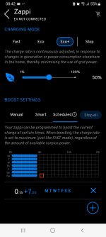

In the zappi app my settings are below.
Do not close the zappi app on your phone.
Hope it helps, works for me.

Hi
It doesn’t matter wether the zappi app is open or closed
I have my slider set to 100% as in photo
All we have to do is plug the cars {MG5 & MG ZS) in, no opening and closing app, and let the zappi do the work
I have set it to charge 3 hours 45 minutes as if I set it to 4 hours it drains the house battery thinking it’s excess solar for some reason
Hope this helps
