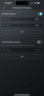

These are the settings I use on our Zappi. You use to have to reset each night but after a recent software update this is not needed. However you do need to leave the App open.
Your also need to set the schedule on the MG app so that the car will accept the charge.
Your settings look correct. I suggest you do daytime checks. I was having trouble with my Zappi but fixed it with a reset. Hold the parallel lines button for 5 seconds
