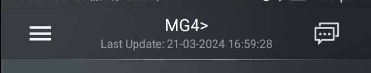

MG4 hasn't been pinging servers for over 24hrs now in Oz. ISmart app shows last update (screenshot).
Seems to not be able to share your phones data because nothing changes even after Auto or Carplay are connected. Honestly, software-wise Mg is very weak
