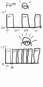

New cars utilise a Pulse Width Modulation technique now.
It allows one bulb to be a light and brake light all in one, yet with one filament to light. Altering the duty cycle frequency alters the perception of brightness.
Using let's I'd say are better because less current is required and they have a longer service life.
