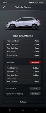

I've got a pressure warning but it's not low so can you re set the sensors? Thanks in advance

Pump them all up a little to (2.5bar / 37psi) and go for a 2 minute drive. There is no reset as there are active pressure sensors in each tyre. Correcting the pressure and having the wheels in motion will convince them to transmit their updated readings to the car.
Pump them all up a little (2.5bar / 37psi) and go for a 2 minute drive. There is no reset as there are active pressure sensors in each tyre. Correcting the pressure and having the wheels in motion will convince them to transmit their updated readings to the car.
Does it not have a re set? My VW had one on on the menu that you just press the set button... I'll do it tomorrow before I chuck it on charge
The type with a reset are generally the indirect type. I’d lay a few quid that it didn’t have a readout of the pressures in the car.
Indirect measures the rotation of the tyres via the ABS. When a tyre goes down its circumference decreases so rotates a little faster hence it guesses there is an issue. The reset sets the baseline of rotation for the car to learn (to account for wear in tyres, slightly different moulding etc) then it can say yep something is different from the baseline.
Our cars have active tpms with actual pressure sensors in the wheels powered by little batteries. More accurate but you will find when temperatures drop, the pressure goes down and they trigger, completely normal occurrence no reset button.
