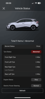

This yesterday

This yesterday

Sorry I don’t see anything wrong with that.
Your tyres are all under 2.5.
The TPMS has some tolerance and three out of four are within that tolerance level but the rear tyre highlighted was outside of that.
The system is programmed in such a way that small fluctuations in pressure don’t trigger the warning, but they won’t cancel the warning either.

You better inflate those tires

Errr... what’s wrong with it is that there is nothing wrong with it…. ?
Exactly. All the tyres are fine, and yet the flag says "abnormal". Ghosts in the machine again.
no the rear right is low. Lower than the others. It was provably at 2.3 when the warning was triggered, it came back up to 2.4 but to cancel the warning it is not sufficient.
Think of it as a trigger range: the pressure must dip below 2.35 to trigger the warning, but must rise above 2.45 to cancel it.
And more over, the TPMS sensor also measures how quickly the pressure drop took place.
Bottom line: put tyres back up to 2.5 and keep an eye on the one reported.

So… what is the point of this warning, if the displayed values are wrong?! This was yesterday, today there was no warning - and I haven’t put a few Bars into the tyre overnight. ?
It got warmer and the pressure rose. But it's likely to go off again next time it gets cold. Better get them all up to 2.5 cold. That'll stop it.
