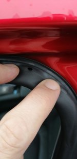

I think I maybe have found out what the wizzle could be caused by in my case, I checked the door seals and everything looked fine in how they fit on top of eachother, but then I pulled back the the top edge and found a hole in it. The hole is exactly where I hear the wizzle come from. Now I just need to find some tape that can stick to the seal, and test it out on the road.

Btw - i think that hole is supposed to be there ?

It is not comming from end to end of the window, just like a small hole, I might try and find some tape that can stick to the seal. The passenger door side is having the hole placed in different places. So maybe I am just unlucky where it is placed on the driver's door. The mirrors cause very little noise I think. But they make a funny swirl with the water as Mark mentioned. I think the roof rails make a sound also, but that varies depending on wind direction, I guess that is to expect.
The holes in the door seals, are vent holes.
They allow the air to escape when the seal is compressed when the door closes.
