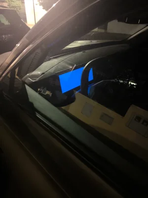

This is my locked car last night after the last jump start. This morning the battery was dead again. Did another jump start and went straight to the MG dealership in Seville.
They seem to know about this issue and that a "reprograming" will be necessary. We scheduled it for monday at 7am. Let's see...

Same problem here. The cause of flat batteries on 2026 MG HS PHEV is the fact that after switching the car off the screen directly in front of you has a backlight and this stays on draining the battery. You can only see its on in the dark. Mine is going to MG tomorrow for a fix.
They did a software update that didn't fix the problem. They then said the screen needed to be replaced. I waited 7 days for them to arrive and the service took some 3 hours. I can confirm this finally fixed the problem.
