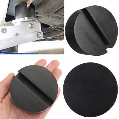

The 'jacking points' are where the joint between inner and outer sills are not shrouded by the plastic sill cover. It may not be apparent that at these locations there are slight gaps between the inner and outer sill panels which presumably are weep holes to drain off any water that gets into the sill cavity.
It is therefore best to use some sort of buffer between jack and body to avoid the possibility of crushing and blocking these weep holes (I adapted a rubber moulding designed for trolley jacks to use with my scissor jack)
Upvote 0
Something like this is useful on a trolley jack to protect the seam of the sill’s.
Upvote 0
