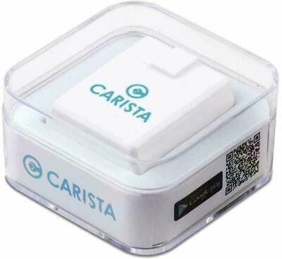

Also any consumption figures for LR ZS in winter and others. Which OBD dongle will work with LR ZS to keep an eye on battery temp? Thanks
Winter range with a BEV is between 20% to 30% below summer range.
I use this OBD2 dongle with the Thia App:
