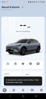

Hi guys,
I have same issue but in MG Marvel luxury
Can we get "pay" other plan then 1024 MB? My car give the information that "less than 10% of traffic consists of remaining data; Pay attention to use or recharge." Now i can't use MG ISMART. Always gave the information " Remote control instruction failed. Please try again later". Any idea for fixe this?
Thx in advance
Pedro from Portugal

Pedro, I've never seen this menu with the red message. Seems not to display on R33. ISmart has always been unreliable, which is bad if you drive using the keyless feature?
The UK does not have the Marvel (yet?). The screen you have is not available in the MG4 and as far as is known there is not a limit on the UK MG4 eSim.
The iSmart error is common in the UK with the most useful solution being to 'wake up' the car by unlocking/locking it but it does not always work.
I suggest you talk to your dealer or wait for an answer on the Marvel Forum.

Thx for info. But with bluetooth i dont have any problem.. they link normal. I can call or make anything as usual.. any tips for why i can't connect with mg ismart?

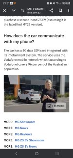

I read this:
