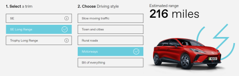

To be fair to MG, on their website they do show range estimates for different situations. They don't claim 280 miles for an SE LR if you are on the motorway.
It would be better if they showed summer and winter comparisons and some of their estimates look higher than I could get, but at least they are giving some indication of how the range will vary depending on how/where you are driving.
You don't have to adapt your driving behaviour if you don't want to. I think it's better to adjust your range expectation according to your driving preferences and plan accordingly. I still drive at 70+mph on the motorway and don't expect to get the 270 miles WLTP of my Trophy.
