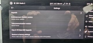

So this is interesting. The MG4 just landed here in NZ and I was super curious to see the story here and how it was being presented. Still has the bulge in the undertray and the air con rattles a bit but not audible in the car. However, I checked the software (trophy spec) and it looks like they are numbering it differently here than in the UK. That’s a bummer as you guys have critical mass and a lot of history. Was hoping I’d be able to ride your coattails for advice and insight but I don’t know if it is possible to map the version in the photo below (again, brand new MY23 with a rear wiper, trophy spec, one pedal drive) to the version number in the UK…any thoughts? Thanks heaps.
Looks like a different versioning numbering for your region, we have seen that before with UK vs EU.
