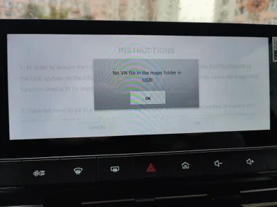

Strange, I see this message when try to update. MG4 Lux 2023 year version.
If you have issues with a missing VN.txt file add this file manually to the USB Stick - This info is from the German MG4 Forum:
Simply add a VN.txt file with the content “pass” (without quotation marks) under the Version.txt file.
I have posted this before.. are you running R46? This could be the issue..
Note that for my MY22 Trophy SatNav version I have to remove the VN.txt file. (As recommended in a previous post see below.) The download from mgmotor.eu does not contain that file so it has to be added.
