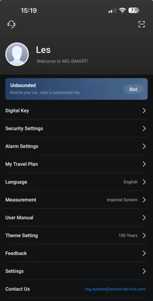

I am logged in on the iphone MG app and its asking me to bind it. Its not possible to bind two devices. If you are logged in with Home assistant it wont let you log in with th phone app. Its one or the other, not both.
I've disabled HA, so I am able now to log in to the app, but its telling me I need to bind it. That's what I had to do when I originally got the car.
Below is my log in to the app. I only have one log in and that is it.
You can set up more than one secondary account, so have the app and Home Assistant integration active at the same time.
The car is bound to the main account only.
I'm obviously doing something wrong here.
That screenshot above is inside my account. I have no settings there until (It says) my car needs to bind. Sorry to be a pain - what am I doing wrong?
