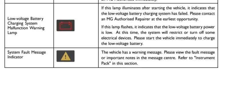

I recommend you monitor your 12V battery voltage via the app to see that it is charging when the car is powered up (voltage > 14V usually) and when not powered up to see if the voltage is decreasing over time (you will probably have to do a few status refreshes to get a consistent report).
Also look out for this fault warning as shown in the image: Screenshot_20250604-163623.webp
