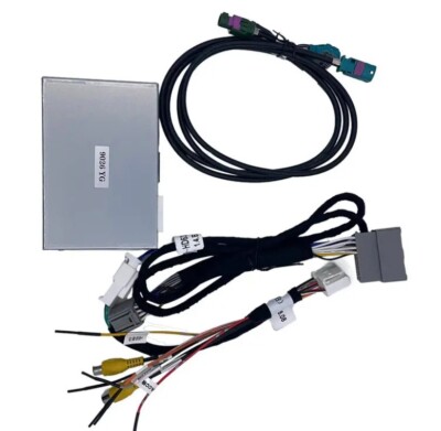

I’m part way through this install (and great videos, thank you!) I have the box connected and it takes over the video when I’m reverse but I’m confused about the camera connection - do I need to connect the pink “rev pow” cable into the camera cable, or is the camera powered at the other end by the reverse light and I should ignore the short red tail at the box end?
Video part two at about 8:00 should show you, but in essence, the pink wire from the AliE box is the power for the camera and is live when you select reverse.
It connects to the RED tail on the LONG vid cable that goes front to back of the car. At the back of the car the similar red tail is now live when you are in reverse, connect that rear red tail to the red or power wire of the camera.
Hope that helps, ask if stuck.
There is a part three as well.
Good luck
Ok what you’re saying makes sense, but the cable they’ve supplied to me is different than what you have in the video. The camera tail is just the 4 pin connector, with no separate power input, and I don’t think the power is going into the 4 pin connector. I attached the link to red at the front, and the camera remains black. So either no power is actually getting into that 4 pin connector or the camera is dead.
I tested the video input on the box with a portable games console and that appeared on the display when in reverse so I know that’s working at least!
Good test.
Your long lead has a red or power tail coming out of the phono plug at each end?
My camera had a 4-5mm 4 pin connector that came with its other half of connector. On the other end of that was the video/phono connector and another connector for power. Do you have something similar?
And the end that’s come from the box, there’s no phono connector at this end, just the 4 pin. There’s continuity from the loose red lead here to the loose red lead coming out of the phono at the box end, but I haven’t tested any continuity in the 4 pin connector.
I’ve also just done a voltage check from the pink wire to a metal part behind the dash, and also the shield on the phono connector - 0V whether the car is in reverse or not, so not sure that pink circuit is working!
I’ve also just done a voltage check from the pink wire to a metal part behind the dash, and also the shield on the phono connector - 0v whether the car is in reverse or not, so not sure that pink circuit is working!
OK in 8150, the small 4 pin connector that connects to the short lead from the actual camera - looks to have a twin power and video cable coming out of it.
I can't see a phono / video socket on the end of the video cable but I assume it's there and you can plug it in to the long cable to the front of the car?
So we should then have a working setup except the camera has no power. I'd then be taking the positive (red or similar) power cable and connecting to the red tail of the video cable from the front of the car.
But your suggesting that there is no 12V on this lead?
Have you a small 9-12V battery you can power the camera with to test??
But your suggesting that there is no 12v on this lead?
Have you a small 9-12v battery you can power the camera with to test??
Bold added to your quote - that’s the part that’s different. The lead in 8150 -is- the end of the long lead. I suspect they’ve messed up what’s included, trying to make it better by just terminating with the 4 pin connector instead of your setup that terminates in a phono and you have a separate phono to 4 pin cable.

Would be good to see a clear picture of your long cable showing both ends.
For clarity, my LONG cable had a phono at each end with a red power tail coming out of it - at each end.
My camera came with two cables, one connected to the camera and terminating in the miniature 4 pin, a second or intermediate cable with the 4 pin miniature at one end and separate power and phono at the other end.
From both your descriptions, it seems this intermediate cable has been done away with??? OR is at least not required.
@DixieTGS could you check continuity from the red power wire at the front end to the 4 pin connector at the back end?
@Edd Beesley do you have access to a meter to check the pink wire goes to 12v when you engage reverse?
Front red to back red and 4 pin
Front phono outer to back black and 4 pin
Front phono centre to 4 pin
No connection to one of the pins on the 4 pin
All wires in the long cable ~8 ohm.

@DixieTGS So you have continuity between the two parts of the phono and the black 4 pin
AND
Front to Back RED and also into the 4 pin.
So I'd personally still be connecting PINK (REV POW) to the red tail of the long video cable and connecting the camera 4 pins together and expecting it to work.
I'd also carefully insulate the black and red tails coming out of the rear end on the long video cable as you don't want reversing power shorting to ground.
But @Edd Beesley this is not working for you?
I'm afraid it's tester time, I'd use a meter similar to this and check that there is 12v first on the PINK wire when you go into reverse and secondly this translates to the red tail at the rear of the car and if you can very carefully check each of the 4 pins to see if you have 12v on one of those.
When measuring voltages make sure you find a good earth for the meter black lead, plenty of metallic parts arn't earthed. As soon as you're done measuring, make sure nothing is live and can't touch earth.

I measured pink with a multimeter and got 0v, trying both a metal point behind the dash and the shield on the camera phono as reference. I’ll try again later on and double check, but I think my pink is dead. But I’m sure I can find another switched live behind the dash and just have the camera always powered.
Yeah that’s the same cable setup I have.
I'm fully expecting this to work.
@Edd Beesley did a check of the pink wire in message #130, hopefully the metal was not earthed as you suggested. Given what I found above, an easy source of earth point would be the black at the rear end of the long cable (assuming the cable and connectors are all good).
I was thinking heat shrink wrap would be the most robust for this.
