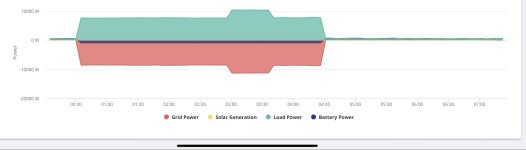

Overnight charge worked a treat. Also, looks like Zappi and Givenergy reporting the car took 7.2kWh from the charger.

Successful charge ?
These are the settings I used in the end although as I don't have any other power sources I suspect the blue leaf percentage doesn't do anything in my circumstances.
I also set the battery to charge to 80% in the iSmart app and it did only charge to 80%
Successful charge ?
All looks good to me. Should only charge during the scheduled hours with those settings and you not having green energy sources.
Edit - as you say, the blue leaf is of little relevance with no green energy available.
