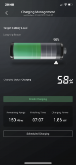

I will hopefully find out more tomorrow and let you know what they say, they have obviously cleared the fault because I can see that it is currently charging when I look at the app so I’m hoping I get it back tomorrow
