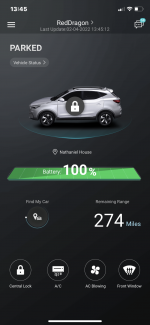

The SOH for my car is ok, I will be going to collect the car shortly so will ask if it’s an over the air update or not, but my car is fully charged and balanced and showing 274 range
