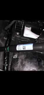

Looks like
Gen1 131
Gen2 SR 331
Gen2 LR 334
I only say that as last 2 pics are only 14days 1 month apart in manufacturing date?
I wonder if different part numbers, points towards different suppliers purely for tracing purposes ????.
Maybe this is the manufactures part number and not the part number used by MG ?‍♂️.
That would explain the dates & "numbers" not both being incremental a la superseding...
However 2 failures with warnings is hardly going to generate a massive witch-hunt & retool is it? ?‍♂️ They'll just bow & scrape a bit & promise to do better. Hopefully they have...

Just for the record folks, he is a photo of my lower steering coupling indent sticker.
It’s a similar pattern of other Gen 2 facelift long range model cars.
I have the part number ending in 331.
It’s production date suggests the 13/12/2021.
Car was collected on the 18th March 2022 so not a massive difference in time scale really, considering the length of the oversea’s trip.
