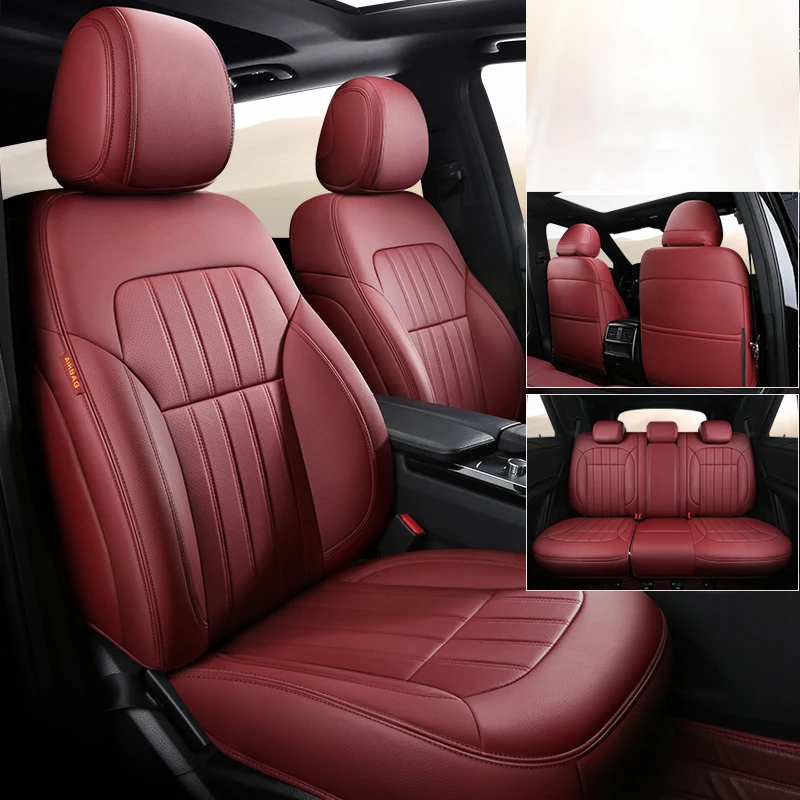

That material looks horribly cheap, in fact much cheaper-looking than the fabric on the SE seats. Also cheaper than the faux-leather on the seat covers I bought.
At £160 for the entire set (back seats too) I honestly don't mind if this wears out in a few years, I'll just buy another set, and maybe change the look while I'm at it. But I'd be shocked if this Aliexpress product wore out in seven months. The car's own seats should be better than an Aliexpress add-on!
Do you have a link to these seat covers?
Here you go.
The basic link takes you to a page that defaults to a single seat cover, but if you click on the different items available you get the full set. This is the one I bought.
I see it has come down a little more (I think I paid £165). The covers are made to order and the seller will ask you to send photos of the car seats before making them. Despite all this a mistake was made in making my rear seats but the seller apologised and sent new ones. (I put the faulty ones in the bin.)
Several forum members have bought these and nobody has had a bad experience. They're not leather, of course, but the quality is fine. Also, that stretchy composite is easier to fit than leather would be.
There are other suppliers with similar products on offer and you might want to browse to see the options for colour combinations. This video (in Dutch) is worth a look. The owner paid an extra 20 euros to have the orange detailing replaced by blue for his blue car, and it looks great.
