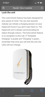

On the Hypervolt, can you lock it to prevent unauthorised use?
