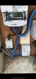

Would octopus agile be better? Could I ask have you two fuse boxes one on the daytime rate and a second box for your storage heater and water heater, this is controlled by the smart meter timer.
I’m attaching a photo of our fuse box, if that helps, we’re getting a proper smart meter installed next week.
But I also spoke the our electric board (who is responsible for the actual wires in the street etc) and they confirmed that we’re on a looped supply but as the adaption is for an electric car, the cost of un-looping the neighbour etc would be covered my them! ?????
This my family member box after installing smart meter you will see two cable from the main supply 100amp fuse to the meter. On the right side bottom of the meter you will see a brown and blue at the back which is the feed to the normal electric and a negative feed to the off peak box, the front brown wire is the timed feed to the second fuse box for heaters eg
