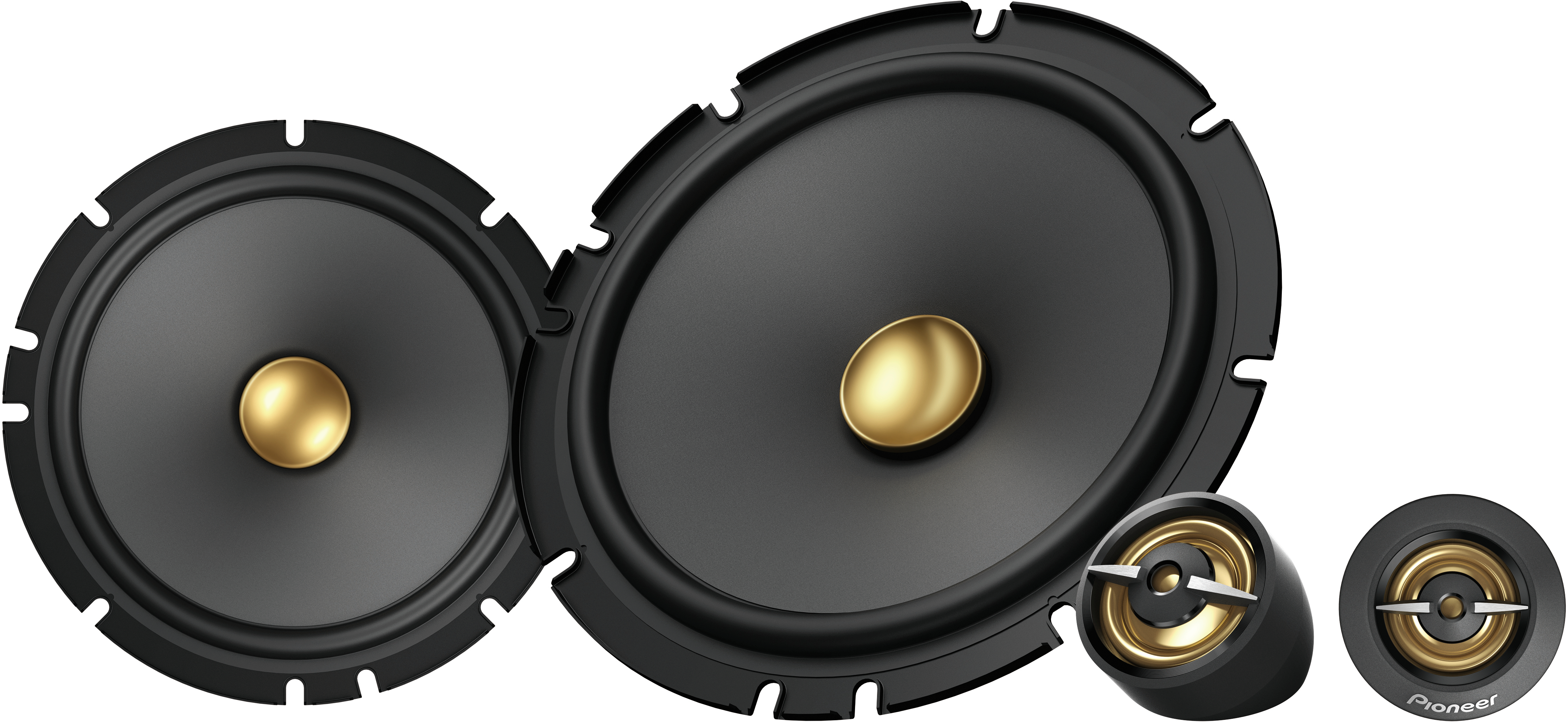

The door panel really gave me a challenge, but this thread might save others from the trial-and-error work.
The first screw was easy but to figure out that I had to pry off the handle and find additional two screws there took a while. Also pulling off the panel itself took a lot of force. Possibly because I didn't manipulate the clips correctly with the prying tool.
It is easy to disconnect the door cable but I ended up hanging the panel on the door to avoid disconnecting the electric cable. If you wanna disconnect the electric cable it might be easiest to take off the panel where the window switches are.
I took out one of the speakers and you can see it compared to the Pioneer here.
At this point, I figured out that I needed to buy some adapters as I don't wanna destroy the original speaker. I'm going for these: Autoleads SAK-3103 Speaker Adaptor
These adaptors are not available anymore..
Any other adapter that fits mg4 original speakers conector?
