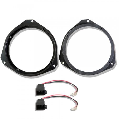

I've had some success with these speaker rings, designed for a Vauxhall Zafira, but they're quite similar and under a tenner:
Left door
Right door
I used washers and/or drilled a extra hole in the tabs to get these on, but the depth and size is good. If you play around with the rotation before you fit the speakers (as I didn't) you might get easier results, but I'm happy! For the cabling I just slid bare wires (ripped from the supplied Vauxhall plug) into the factory connectors and taped them up, seems OK, and the sound is SO much better (even though my Alpine's are a bit battered)! The OEM speakers are definitely a weak link - the amp is actually not bad (even on the SE).

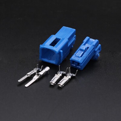

Some may find this useful - I found the correct connectors to attach to the OEM tweeter plugs. They are called DJ7022Y connectors (though this sems to cover a few variants) but I found the right ons here:
Handy if you don't want to cut the factory plugs off! I would recommend buying a five pack as the pins are a tad tricky to crimp so get some spares, and delivery takes a while, like 4-5 weeks (to the UK).
Here's one clipped on (before pins/cable added). (You will need slim cable similar to the factory gauge as thicker stuff won't fit):

Thanks for this. Out of interest, have you purchased after-market tweeters that are a straight swap?
Thanks for this solution!
Is the sound quality noticeably better than the trophy speakers? I thought they did an alright job
Thanks guys. I had some existing Alpine tweeters that match the mids I fitted earlier. I also re-located them to near the mids just inside the footwell as I much prefer that soundstage. (Years ago a pro advised me to use that location with the left tweeter pointing at the drivers left ear, and the right one at the passenger’s right. It really works, I’d say give it a try). I just stuck them in place with a wedge of blu-tac which allowed me to point them appropriately, was easy, surprisingly secure and you can’t see the blue backing very easily as the tweeter mostly covers it.
