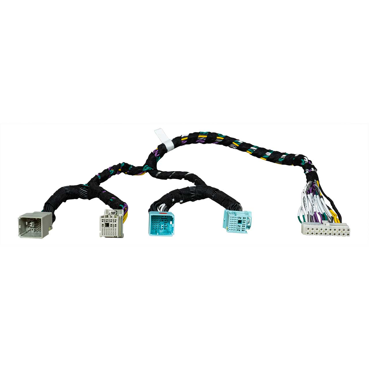

After @shinyrobot linked the MG harness above, I looked into Match, and they do a 5 channel amp with DSP, which should improve the sound even further. I've done the Vibe speaker upgrade, it's clearer but the bass isn't to my liking. I've had to greatly reduce the treble in the factory EQ, which is only 5 band. The Match 5.4DSP has a 30 band EQ, available for each of the four channels, plus time alignment etc. Match also do a small 200W sub (PP7E-D) that's suitable for the amp/DSP. Seriously thinking about getting this kit. It will be mostly plug and play because of the harness. Although the installer wants to power the amp from the fuse box rather than direct from the battery with inline fuse, which I find weird?

Has anyone found an audio T-harness for the MG4 yet?
Looks like audiotec-fischer wins first prize.
Anybody know if this works wothout the Match-amplifier?

You should be able to rewire that harness with a suitable plug, just need the MG4 wiring diagram, it's on here somewhere.
I'm getting a Match amp installed next week with that harness.
