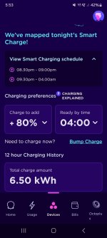

Go into the Octopus App, you should have a 'devices' tab, click that and you should get:
NOTE the % is the amount of charge to ADD not the total you want in the car.
hi
Thanks , this is what I have been looking for but sadly does not appear, All I get is a small windmill when I press the device tab.

Can you add a picture of your schedule please.
