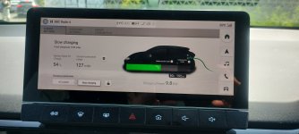

I thought I would let others know that 11 KW charging is still coming through on Trophies. I took delivery last month of a Trophy (built Jan 2023) and have now had a chance to charge with a 32A 3 phase cable. Screen shot clearly shows 9.8KW, so that's good. Interestingly my dealer decline to supply a type 2 cable with thw car, saying they were £260 from MG and that I would be better off going on line to buy one. As they had given me £250 off the list price I guess that's a fair deal.
