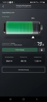

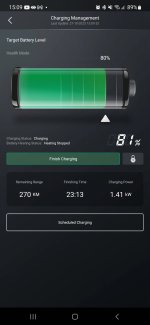

that's an interesting question. I thought on that. Let me do this, I'm going now to the car and remove any scheduled charging time (I did indeed have it). Let me see if it charges beyond 80% or if it sticks at 80%. It's, at the moment, at 79%. I'll be back here.
It still goes beyond the limit. :(

79% with the limit at 80%. it's now at 81% still charging.
