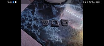

One of my pals has asked me to print the files they have bought from Cults3D. My day job is a mechanical engineer and I've printed off a variety of things over the years... so if you find a local willing to print this for you, be aware of a few things:
1) PLA is easiest/cheapest to print. But it will warp worse than Bradley Wiggins' Banana in the hot humid conditions in your car. I'd give it two weeks lifespan. The photo is of my test print in PLA. Will not be used in anger!
2) ASA is probably the best material to use (using non-pro plastics) as its UV stable and high heat resistance (up to 93oC according to Prusa)
3) To seal the window I'd recommend 3M helicopter tape. Its strong.
Yeh, I’ve done my test ones in PLA. Last time I used ASA filament, I didn’t have much success. Do you have any you would recommend?
