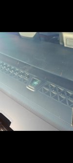

Now fitted the clear sticker over the cut out. Works perfectly and no dust ingress.

With the bright sunlight (finally) in the mornings, my auto lights gone on and off all the time when passing shadows caused my trees, etc. Decided to print off and try the 3d printed ASA covers and see if they deform or not.

I just spent a little while this afternoon prising the cover off my light sensor. I managed it without breaking anything. I have fashioned a temporary dust-cover using a bit of polythene and "super-clear" Sellotape, which doesn't degrade in light the way the normal stuff does. We'll see how long it lasts! Pro tip. It looks really, really naff.
Going forward, I hope @TrullT will be able to produce 3D printed covers from Pliskin's file. Failing that, I'll drill a hole in the original cover as others have indicated. Supposedly, this does the trick.
