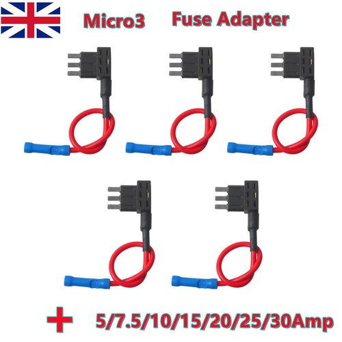

For the piggyback, I got this pack from Amazon:
Amazon product ASIN B09VYQGPZZ
It's the Micro ones that you need.
Shouldn't need anything else

Great. One more question, your photo in post #70 - the permanent live is the micro piggyback connector right? The switched one is that a standard size?
Crap.. Yes :( The switched one is one of the 3 pin fuses
Totally forgot about the different sizes, sorry!
Looks like they're out of the 5A ones
OK. so I am waiting for a 3 pin piggyback cable to arrive.
