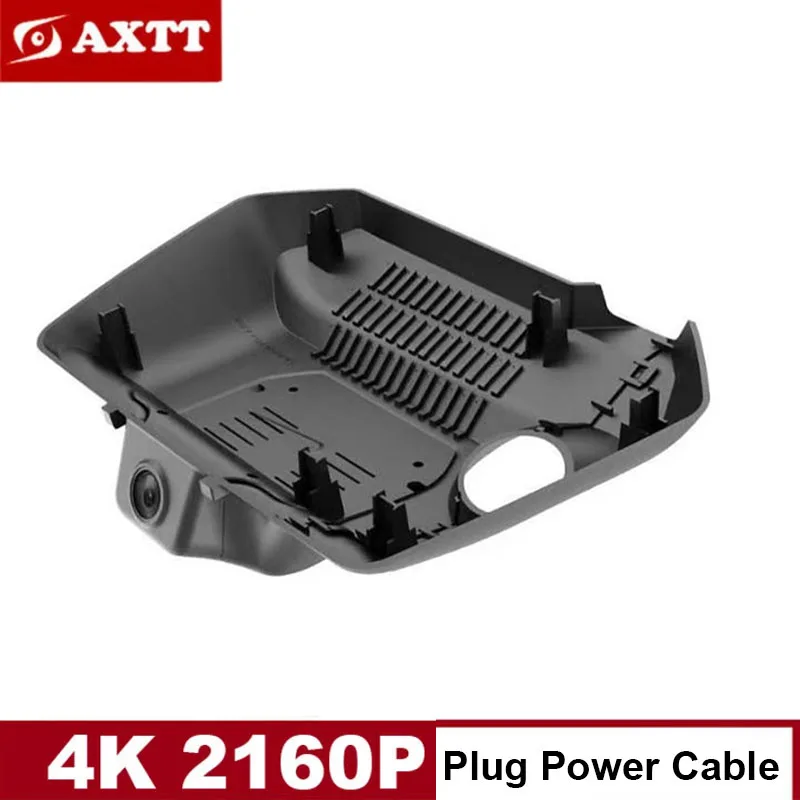

Earlier in the thread, @Shanecb posted a dashcam they found on Amazon that's built into a replacement mirror cover and taps into that feed.
Thanks, I believe that's similar or the same as this one on Aliexpress:
However it looks like it's intended for LHD cars as the hole for the rear view mirror is on the left, and it would need to be mirrored for a RHD car.
However it does look like a nice solution, and it would be great to be able to get power from the mirror as it would save running extra wires from the fusebox.
