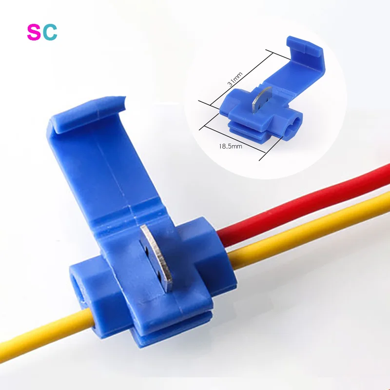

Or you could use below things to take power from the lights wires, again need find out pin out first.
£0.41 76%OFF | 10PCS/20PCS Wire Connector Scotch Lock Snap AWG22-10 Without Breaking Cable Insulated Crimp Quick Splice Electrical Terminals
