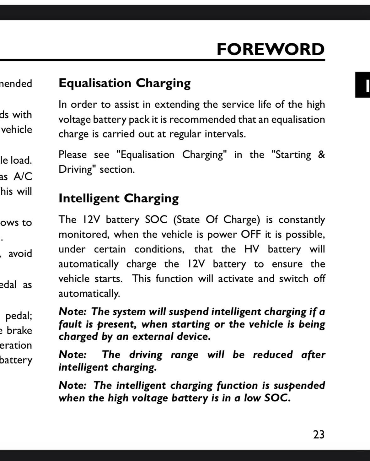

I’m not sure if the ‘intelligent charging’ feature is well/correctly implemented by MG. From other posts on the forum relating to 12v battery and my experience (others have reported flat with rescue call-outs) I have never seen this feature activated. The 12v battery is only 45ah so only 0.54kwh to fully charge from flat so minimal impact on the hv battery and range.
